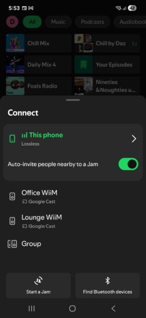

I've recently been experiencing an issue with spotify whereby my two wiim devices are defaulting to google cast rather than spotify connect (see attached). I don't have google cast enabled in the app for either device and have never intentionally used this connection option previously. The only workaround Ive found so far is to quit both apps and then turn wifi off and back on (sometimes need to do this twice) to get the spotify connect option to show and work again. Anyone else experienced this or have advice on how to fix it?

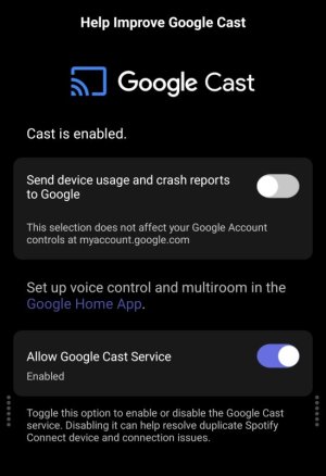

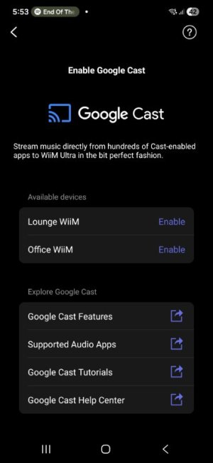

This is a known issue affecting some smartphones. After enabling Google Cast in the WiiM app, then please turn off "Allow Google Cast services." It might seem strange, but this should resolve the issue.
That seems to have worked, thanks! Very counter-intuitive though as you noted.
