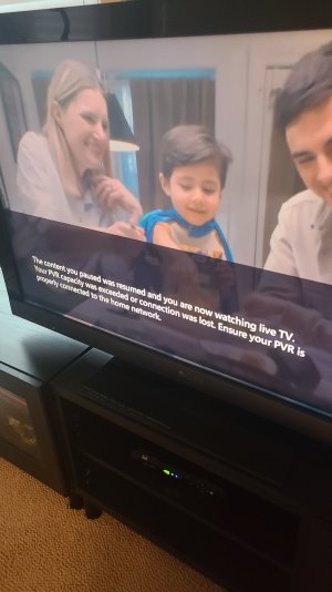

This problem is also happening with me. Playback on Bell vip2502 units attached to main pvr unit are effected and won't allow to skip, rewind or pause content, sometimes displaying the attached message. Also wont playback shows that are already recorded to PVR. Had no idea the WiiM would interfere with the wireless capabilities of the Bell recievers. Unplugging the WiiM fixes these issues. Wondering if any of you have the WiiM Pro and experience similar interference. Thanks
