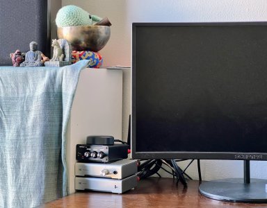

I'm using Amazon Music. I do not have any connectivity issues with my Denon. I'm using a Google Nest Wifi mesh system with PLENTY of bandwidth. The Mini is sitting on top of the mini-stack of Aiyima A05, Schiit Magni3 and Modi3+ and between a monitor on my desk and flush with a bookshelf that's next to the desk. The Mini is on the same side of the bookshelf as the nearest wifi hub. Because I'm using the Wiim via optical connection, I'm not using the Bluetooth built into the Aiyima.
I provided feedback (#491216) through the app. I wanted to post here to provide visibility on the frequency of the issue in the hopes they will fix it.

Seconding what @Brantome suggested, try moving the wiim mini away from the stack and retest.
