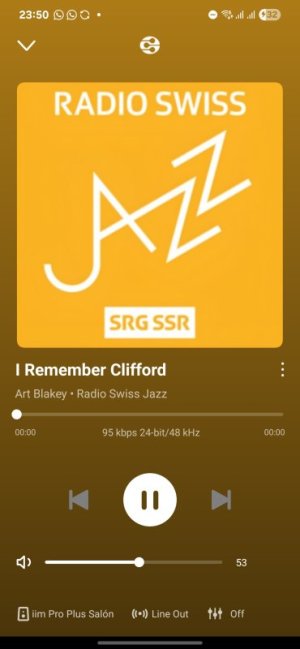

It is aac+96 24bit/48khz. It is superior. Also the broadcast radio annouces it as it superior quality stream in its page...yet tuneIn selects automatically the mp3 128kbps. TuniIn app also does the same by the way, so apparently the wiim firmware is just replicating what the TuneIn app does.
I know the 96kbps AAC+ stream is better than the 128kbps MP3 stream but why do you think the AAC+ stream is 24 bit?
Why not? 24b is becoming standard for high-res audio so the've chosen to sample their media using this bit depth. It is probably default of aac encoder. Radio Swiss Jazz aacPlus streams are all 24b/48khz and they offer in their page 32, 48 and 96 kbps, being the aac+96 clearlly advised as the best quality stream of all. Still tuneIn selects the mp3.
Do they say they are 24/48kHz? All the info on aac+ seems to say it doesn't really have a fixed bit depth. I don't even know how to tell. Most DACs only display sample rate.
24bits 48khz is the bit depth and rate at which the audio encoder (in this case aac+) samples the original uncompressed audio signal. Then it applies its compresion algorithms on top of this, and the out file in aac+ format has a variable bitrate, yes. 96kbps is the target average rate set when encoding, but each second of the track the bitrate may vary up or down depending on the conplexity of the song. Media players will normally display average bitrate of the track.

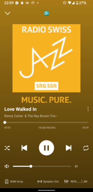

If I play the same stream from Lyrion to my WiiM Amp the WiiM Home app reports 16/48. How do we know which is correct?
I have used Wiim's Home App "Open Network Stream" to open de URL on my Pro Plus so it is Wiim Pro Plus directly connecting to then URL decompresing to PCM at the maximum bit depth wiim pro plus allows, 24bits, and finally DAC outputingitin my case to analog line out to my amp. Don't know what that Lyrion is but if it is some media server you've installed somewhere else it may be just decoding then signal and resampling it to 16bits as 24bit output may not be supported. Try Open Network Stream and let the decoding happen at your wiim amp. You'll surely see then the 24bits in wiim home app player.
