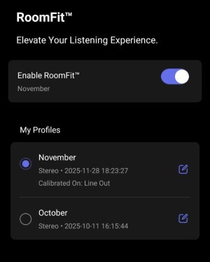

Could you please post screenshots of the EQ screen and the RoomFit screen here?
Please note that EQ is switched off after RoomFit run. Is both EQ and RoomFit enabled on the Ultra in the lounge?
EQ and RoomFit are separate functions. EQ can be applied over RoomFit.
Thanks again for the response - yes I can confirm the EQ has been switched on as well as RoomFit on the Ultra in the lounge and the EQ settings have no effect on the sound.

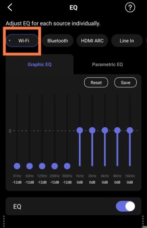

That's odd..
Open the Ultra EQ screen in the Lounge and try setting it up like this.
(Please ensure the Wi-Fi input is selected.)

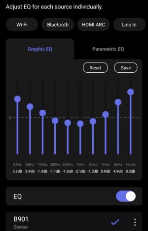

Can you no longer hear the bass from the speakers?
As the EQ can apply different filters to each input, please select the input before making adjustments.
Switching this to wifi has resolved my issue. Thank you very very much & have a great weekend.
EQ is per input and only work for a physical output of the device, not a link or Bluetooth (DLNA?).
A linked device (follower) receives the data on the WiFi/Ethernet input, so the EQ shall be used for that.
