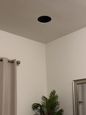

Greetings everyone.
Hi guys, I have decided that I need to order my pair of Yamaha ceiling speakers. I want to be wise and go straight to my goal which is to use Spotify Premium with a WiiM Pro.
All I have at the moment is the speaker cable and mounting ready but I need to figure out which component will supply the sound to the WiimPro. My setup is a living room setup, as pictured here: IMG-2797.jpg
There is 1 more speaker location and that is it for my living room. No subwoofer at this time.
Please forgive my lack of knowledge if I am missing something but from what I can figure out, I need to purchase speakers, speaker wire, a WiiMPro and I need some type of receiver/amplifier, correct? I guess my specific question is related to the fact that this is only a 2 speaker setup and my reasoning behind that assumption is whether I really need a very fancy receiver or if the possibility exist where I can buy something small yet decent quality that I can wire my speakers to for power.
To be honest, I would like to keep the budget for this component to a maximum of the price of the WiimPro x 2, is that possible? or do I need to spend 3 times, 4 times or 5 times the cost of a WiiMPro to purchase this needed component. I am specifically excluding any specific name for the component like the terms, DAC, receiver, amplifier because I do not exactly know what I really need, and what I do not need.
I have iPhones and basically I want to send my music from Spotify, whether it is from a MacBook or a guest Android phone, over wifi through the WiiMPro capabilities.
