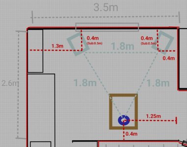

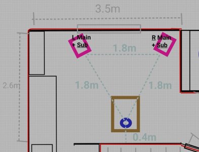

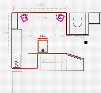

[My room]
This is before the change (April 20)
After the change (June 3)
Initially, I had chosen a 1.5m triangle to move the listening point away from the back wall, but I decided on this distance because the speakers were too close and the scenery reflected in my eyes was unpleasant..
This is actually an arrangement I have done before, but now I have moved the speakers even closer to the wall.

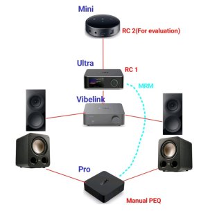

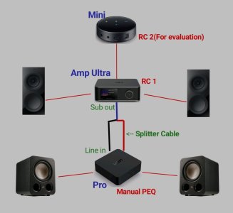

I'm using Ultra and Pro to operate 2 Subs.
The 2 WiiM devices are linked by MRM.
I also connect a Mini to the Optical-in of the Ultra to evaluate the room correction results for the entire system.

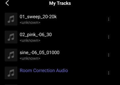

Specifically, adjust the Pro line out level and volume limit while gradually increasing the group volume to 90% in WHA, and match the volume of the main speakers and Sub. (At this point, the Room Correction Audio saved in WHA's My Tracks is played back on repeat.)

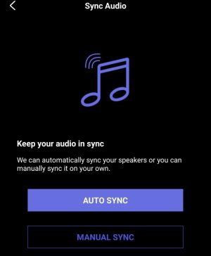

Next, I used "Sync Audio" in the Ultra's device settings screen to compensate for the delay between the main and sub.
Here I used a 100hz sine wave downloaded from the web and set it to the value at which the volume was loudest while adjusting with MANUAL SYNC. The result was 1 ms.

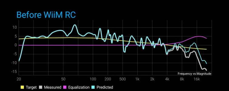

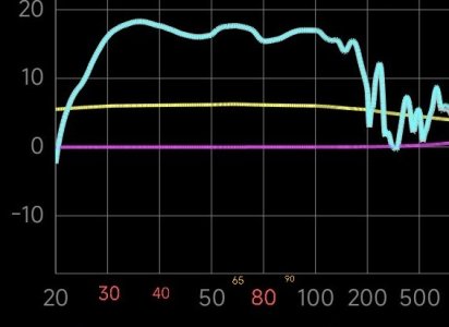

Before I could do this, I needed to know where the X-axis (frequency) was on the graph displayed in the WHA RC results, so I repeated the measurement several times to create this.
It would be difficult to adjust the 2 subs using only auto RC, so the Sub is manually corrected with L/R PEQ while watching this graph.

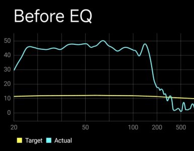

This is the 2 Subs response measured with RC with EQ disabled.
And this is the result of measuring the left and right Sub separately.
The left Sub has a large dip at 70hz and the right Sub has a dip at 35hz. I decided to look at this and adjust each side while repeating the measurements on the MMM RC.
(The left and right Sub is adjusted individually while watching the stereo RC response.)

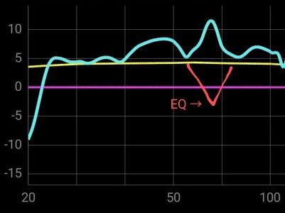

e.g., to flatten the peak at 75hz, calculate the EQ value that results in the same shaped dip.
My method of calculation is very rough and I could be wrong, but I am making a rough adjustment here and fine-tuning it later.
The Q value of 1 octave at ±3dB gain is 1.41, so it can be roughly calculated from here.
1oct : Q 1.41
1/2oct : 2.82
1/3oct : 4.23
1/4oct : 5.64
1/5oct : 7.05
1/6oct : 8.46
1/7oct : 9.87
1/8oct : 11.28
1/9oct : 12.69
1/10oct : 14.14

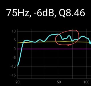

The range I want to adjust is generally 60hz-85hz. 1 octave above 75hz is 150hz, so I'll make a -6dB EQ at 1/6 octave to try it out.
Result
Only the peaks could be shaved off a little. To increase accuracy, fine-tune by changing the frequency to 73hz or increasing the gain.

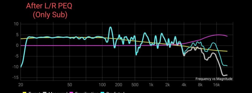

After adjusting one location, run RC to see the results.
I must have repeated this process about 30 times...
After several hours of work, I was finally able to correct it like this.

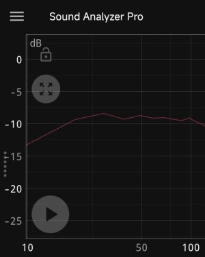

From 25hz to 100hz is generally ±1dB. I honestly don't know if I need to go this far, but it means a lot to me that I was able to achieve a very clean flat using only WHA.
I evaluated this in my Android analyzer app which use all the time.
It seems no problem.

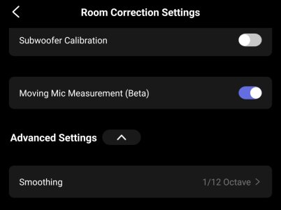

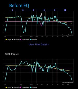

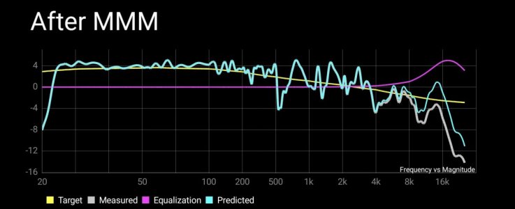

Next, today I adjusted the main speakers to use the MMM (Moving Mic Measurement) on the WiiM RC.
This is the response before adjustment. (All EQ is off.)

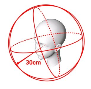

During the first sweep measurement, the mic was fixed on the listening position, and during the pink noise measurement, mic was moved 30 cm range around the head.

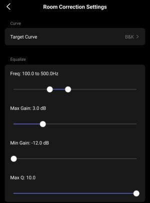

This is my RC setting.
Target : B&K
Freg : 100-500hz
Max Gain : +3dB
Min Gain : -12dB
Max Q : 10
Smoothing : 1/12 oct

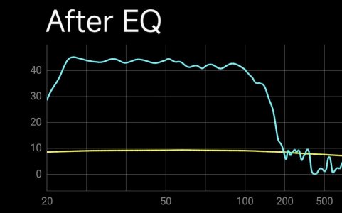

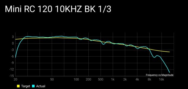

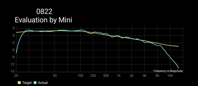

After MMM RC
It is now about ±2dB at 100hz-500hz 🙂

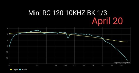

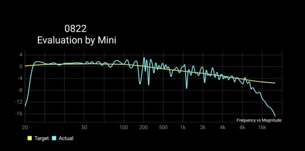

This is the response obtained on April 20 (prior to the room rearrangement).
This was the only image left that could be compared, so I ran RC under the same conditions using a WiiM Mini.
And this is the result of today's correction.
Better!

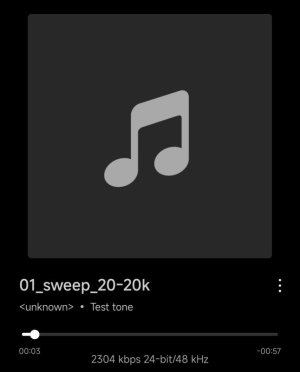

I started, as always, with listening to sweeps.
Play the 105-25hz and 110-30hz test tracks on Amazon music.
88981de9-5c79-4ce1-a4cd-229336f7805d-1_all_10102.jpg88981de9-5c79-4ce1-a4cd-229336f7805d-1_all_10101.jpg
It is the smoothest I have ever heard. It's perfect except for the fact that I can hear resonance somewhere in the room...
Then listen to the 20-20khz slow sweep.
It sounds a little strong around 1khz-2kHz, but that's ok.

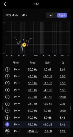

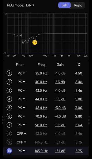

These are the PEQ values applied at the WHA this time.
[Left Sub]
[Right Sub]
Since a low-pass filter can't be applied on the WHA side to the Sub connected to the Pro, the low-pass on the Sub side was set to 100 hz and the PEQ was lowered to 145 hz.

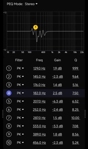

The main loudspeaker was taken directly from the MMM RC results.
(The MMM response was the smoothest.)
I hope that in the near future the WHA RC frequency graph will be more readable and accurate.
[Left Sub]
[Right Sub]
