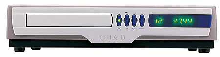

I'm not connected to the Quad CDP-2's (optical) digital input, but it doesn't work. Also, the M2 Tech Hiface still doesn't work from the Dac's digital input. I have two separate optical cables, one is the cable that already comes out of the Wiim pro plus device, and the other is a different brand optical cable.
The DAC of the quad CDP-2 appears to be 24/96.

When I connected the RCA cable that came with the Wiim Pro Plus as Coaxial to the M2 Tech Evo Dac, I was able to get a 192 kHz output. However, I couldn't get it with the Quad Cdp2. It is confirmed that the Quad supports up to 96 kHz. Additionally, it has become clear that there is no issue with the Wiim Pro Plus providing at least a 196 kHz output as Coaxial. Now, I am waiting for my Denafrips device to arrive. I am curious about how the performance will be when using the Wiim Pro Plus and Denafrips Ares 12 together. My Pre Amp is the Quad Qc24 with tubes, my Power Amp is the Quad 909, and my Speakers are the tower type Quad 22L2 with upgraded internal wiring using Cardas.
