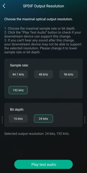

By the way, After switching the WHA output to coaxial, "SPDIF Output Resolution" plays back the test audio and there is sound.
Why?🤔

Don't see 192kHz on the screen for "SPDIF Output Resolution"?
I removed that part of my post because it was incorrect. I was blind and missed the 2nd row. :)
