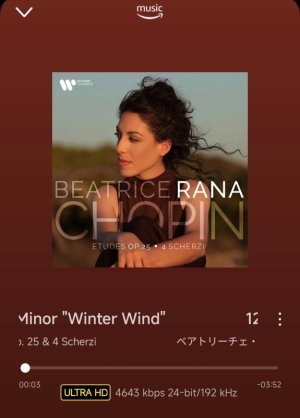

Not sure if this is what you're looking for but I'm seeing 24/192 in the WHA when casting to my mini from the Amazon Music app. I also tried it from the Alexa app with the same result.

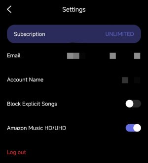

User error, sorry. I thought I had checked everything but the Amazon music HD/UHD toggle under Alexa was off - an app or firmware update must have flipped it off and and I hadn’t noticed. Don’t recall factory resetting the device in aeons either.
