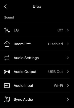

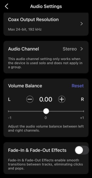

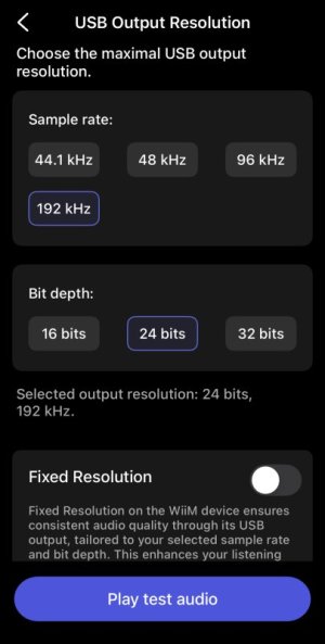

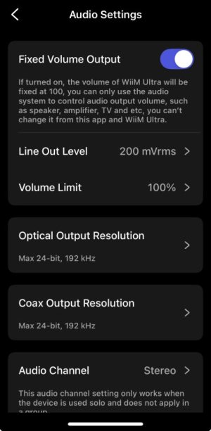

I'm not denying that you heard different. I'm saying something was probably not configured right. Lock volume. Zero PEQ. Zero room correction. Zero DSP (bass management/crossovers/filtering). Zero sample rate or bit depth locking. This should and can allow bit-perfect from the WiiM. It's also a lot to configure and easy for anyone to miss any one step and considering ALL of those steps must be followed, I'm sure 80% of people aiming for bit-perfect from the WiiM streamers misses their bullseye.
And FYI I also am an Audirvana user for my personal library. I get what you're saying about the sound. I really do. I'm just saying that I disagree with you on it being impossible with the WiiM--it's just very difficult and annoying.

Yeah true, but lacking that some of us have long known what settings to set or defeat to achieve WiiM ‘bit perfect’. My Pro and Ultra have those settings correctly applied since day one.
