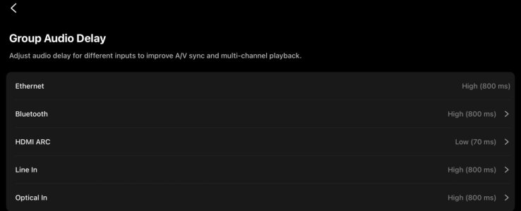

While this setting seems it should only be applicable when doing group output, it has been discussed here that the group audio delay settings fix this. Setting mine to “Low (70ms)” fixed the sync for my Apple TV.
