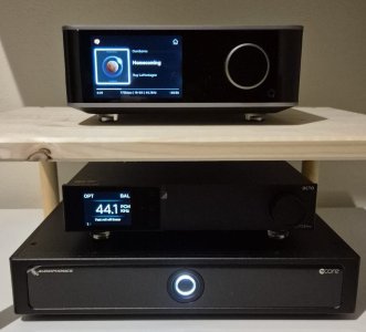

I have a Audiophonics AP300-S250NC connected to my Ultra, not directly but via a Topping D70 Pro DAC. Before I had the Vibelink Amp.
My impression is that this Power Amp module is fantastic, plus the build quality of Audiophonics case, connectors and wiring quite great. I'd recommend it. Plus, the staff at Audiophonics is helpful and really keen to answer any dumb or great question you may have.
A single small warning: the front facing white led, that turns on when the amp is powered, is quite bright for my taste. There is no dimming function, to reduce the intensity the only way is to add a resistor to the wire from the LED to the button.
On my speakers - Acoustic Energy AE500 - moving to the S250NC provided more presence to the sound even at low volumes, kind of higher "pressure" (but is just feeling, not measurements). I'm happy of the switch.

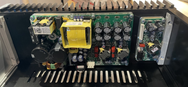

They run hot, so I'd choose the build with the best cooling. This is adequate.
I'd say the case (and therefore cooling) from Audiophonics is a good one on this regards. Vented ports top and down plus heat sinks at both sides, plus space.
Many not be great as a custom build, but feels more than adeguate.
