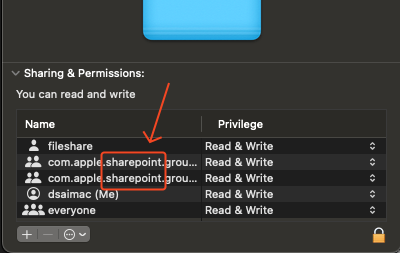

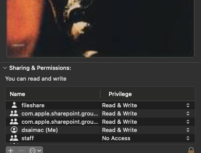

Agree, appears to be a authority issue. It created 2 users (probably after successful connection) and they were read only, so I granted read & write.
I feel pretty confident that it's and windows mac thing, now that I see that, evil "sharepoint" is involved. I did have to enable the windows option in the Mac's file sharing, but, no change in behavior.
Folder Permissions:
mp3 Permissions:
