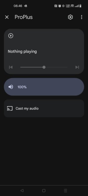

Hey,
Does someone use chromecast feature like "Airplay"? So for casting audio only. It is recognized on my android phone as sound + screen so it is really weird to cast "entire" screen or app when just audio is needed. In Google Home app I can see as "Cast audio" but after clicking on it it asks for screen or app.
Did someone find a solution to this. I wanted to have it similar to Airplay where you can see it as "speaker".
It is Wiim Pro Plus so no HDMI or any screen that would be suitable for screen casting.

Could you please provide some screen shots to help us better understand your question?

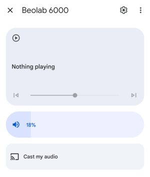

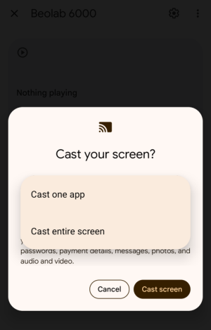

Here are screenshots of user flow that is happening. At first it is "Cast my audio" then mixed up with screen and in the end app or screen, no audio only option. I don't have option to try another Chromecast device if it is phone or Wiim issue unfortunately :/.
View attachment 26867View attachment 26868View attachment 26869
Thanks. I still don't understand the issue.
How is this related to the WiiM?
Are you trying to send the sound from your phone to the WiiM using Chromecast?
To send the phone sound to the WiiM, you can use Bluetooth.

Just did some tests on a Android phone and when the WiiM device is added to the Google home app, then I can cast the sound only.

If I get it right, then you did not get modal that I got with "Cast your screen?" message right?
I installed that app on my android phone and could cast audio no problem to my Pro Plus using the cast audio option in the Google home app.

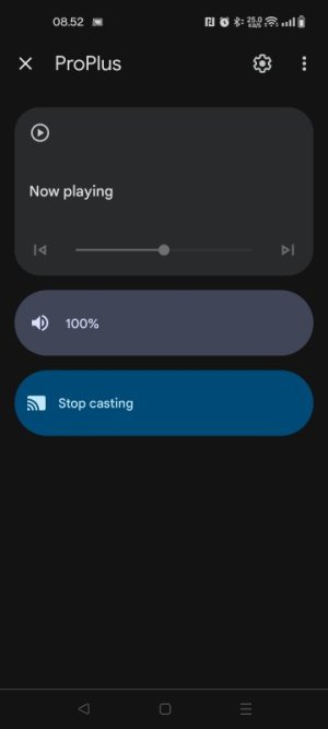

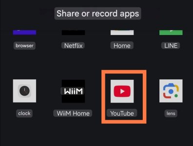

On the last screen, tap 'Cast one app' and then tap the Youtube icon.
The Youtube app will open, play the video and you will hear sound from the Pro plus.
(Similarly, tap on the app you want to use.)

In addition to that you can also mirror content from your phone through the Google Home app but this is rather a secondary function. When I select my WiiM Amp Pro or my WiiM Amp Ultra in Google Home I can mirror e.g. the YouTube app and it will mirror the sound only to my WiiM.
