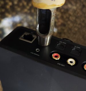

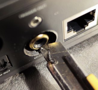

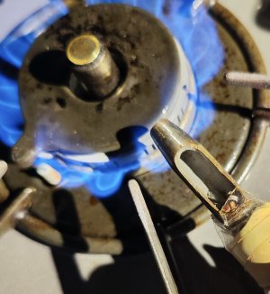

I destroyed with a high fever.
Opening the port is the correct solution. Manufacturer refuses to admit. Connectors on standard SPDIF Coax cables might not fully attach as intended. I suspect tolerance stack up is a factor so YMMV regarding "good enough" connection. Cable length and cable quality become factors when the connection is electrically less than optimum. I completed many repeatable tests between mid-Jan and mid-Feb. One test used a new 3ft media bridge. Caused dropouts just like my old 3ft monster. Dropouts via WiiM resolution test as well as my preferred Amazon test track, Barracuda by Heart 24/192 4662 kbps. Currently using CESS-163-1f rca audio cable with T9 Pro and Ethernet. At some point I will use a 30ft rg6 coax with f connectors and rca adapters and I bet it will work fine (& port bore-out?). This box can be stashed far away where wifi doesn't exist and space isn't a premium, as long as the SPDIF will go the distance (spec is 10m). Yes, the optical on my T9 Pro is used by the TV, and yes, I could use my hdmi breakout to swap the spdifs and use optical from the WiiM, but I'd have to buy a long optical cable.
