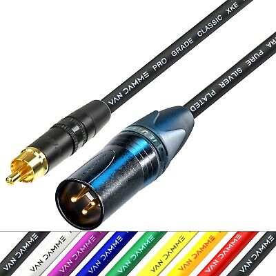

You connect the OUT from the Ultra into the power amplifier. You'll need RCA-XLR MALE cables, a pair.
Buckeye Amps tell you exactly that in their FAQ page (because they do not have RCA inputs, but XLR inputs only):
The cables mentioned above should be ok. Since you appear to be US based you might prefer buying from a local seller. One such outlet would be Blue Jeans Cables, offering extremely high quality products at still reasonable prices. You are looking for an RCA M to XLR M cable, 2 channels:
