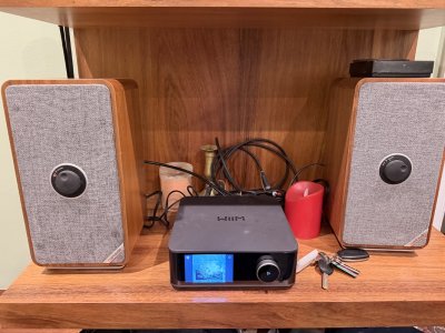

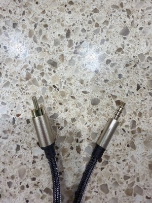

I am having difficulty connecting my new WIIM Ultra to 2x Ruark MRX speakers - I am using 2 RCA to 3.5mm jacks (each from rear of Ultra to rear of speaker), switching Ultra to line out - but doesn’t work at all.
Speakers work OK with Bluetooth but I want to connect by cable.
To be honest, the Ruark speakers have always been a pain so it doesn’t surprise me they are not working now - I had hoped that wiring them to a WIIM Iltra would make them more obedient!
Any thoughts?
Thanks
Any thoughts?
Thanks
