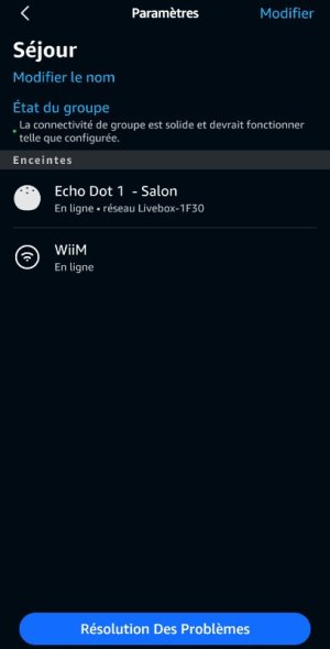

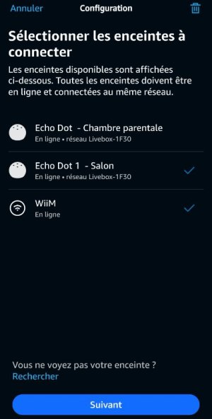

Regarding the default speaker it's a total no to set the Wiim as default because the goal of it is to modernize my hifi that is of course never ON, except when I want to listen to actual music. (My AV Denon amp don't have a trigger in plug)
All the rest of the time the living room echodot must remains the default.
You don't need to set WiiM as the default speaker for your Echo device. Create a group on your Echo and designate WiiM as the preferred speaker for music within that group. This means WiiM will only play sound when you instruct it to play music via voice control. Additionally, you can omit the WiiM name when using voice control.
"preferred speaker for music within that group"
Hmm 🤔 how should I do this please?
