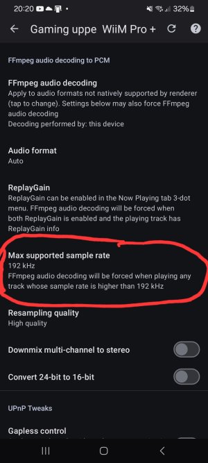

I have two local server options, DLNA/UPnP, and LMS. Of those two, LMS can easily transcode DSD files on-the-fly to 24-bit PCM. DLNA/UPnP should also be able to do that, however at least in my case that produces silence on the Pro Plus, whereas LMS plays music, so for me personally it's solved without actually being a finished feature with an available setting on the WiiM devices.

I've also have a lot of DSD on my Synology NAS ds1821+ running minimserver and bubble UPnP as a control point. It works great, Bubble transcode the files on the fly for playback on my Wiim pro plus. The files get transcoded to 192 kHz 24 bit. 1000030268.jpg

I can easily play the .dsf files from SACD rips, on nearly all of my gear. The WiiM was one such exception until I figured out that whatever the LMS server is doing for on-the-fly conversion to 24-bit FLAC is working with the Pro Plus, where it does not with my particular DLNA/UPnP server instance. So it's problem solved for me, but it would be nice if I (or others) had the option to have that transcode occur at the endpoint and not server side, and it shouldn't be too difficult given it's been available for years on free software such as Volumio, Moode, RoPieee, piCorePlayer etc... and it is on WiiM's roadmap. I'm guessing it got deprioritized on their end when no one upvoted it here, bumping this thread whose inception dates to one year ago was an attempt to get eyes on it and hopefully some upvotes.
