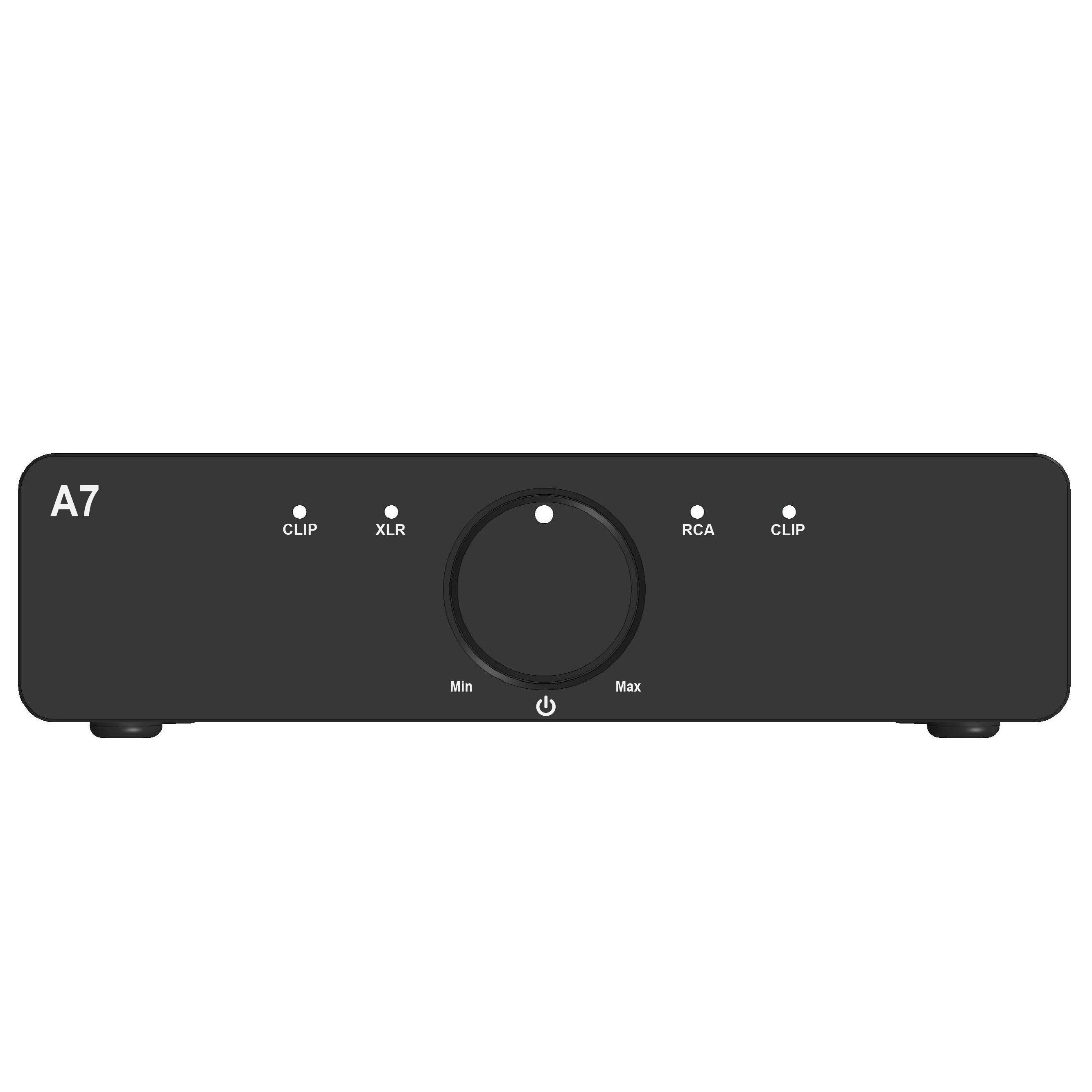

Power will be plentiful, that's no issue at all. I also acknowledge that the ZA3 can be had really cheap. But if you are interested in getting the best sound quality from you minimalist system and even plan to replace the excellent DAC in your Ultra with something else, why go cheap on the power amp?
Until WiiM might come up with some amp to suit Ultra owners (please, please), I would rather go with the 3e Audio A5se:
Not as cheap as the ZA3 and less maximum power, but clearly cleaner measurements and pretty much no load dependency. If you can stretch your budget a little, the non-se 3e Audio A5 is even better into lower loads.
