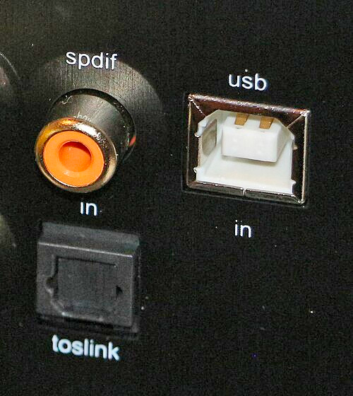

When playing FLAC files from my Minimserver media server, which were ripped from my CDs at 44.1 kHz/16 bits, the Wiim pro outputs a 44.1 kHz/ *24* bit PCM stream over optical SPDIF/toslink. I am connecting the Wiim Pro to my Minimserver via the Home Music Server tab in the Wiim Home app on an iPhone, then selecting albums/tracks to play. The optical output goes into a Linn Klimax DSM, and that is what is reporting the higher bit rate. I have the optical output set in the Wiim Pro for a maximum of 192 kHz/24 bits.
