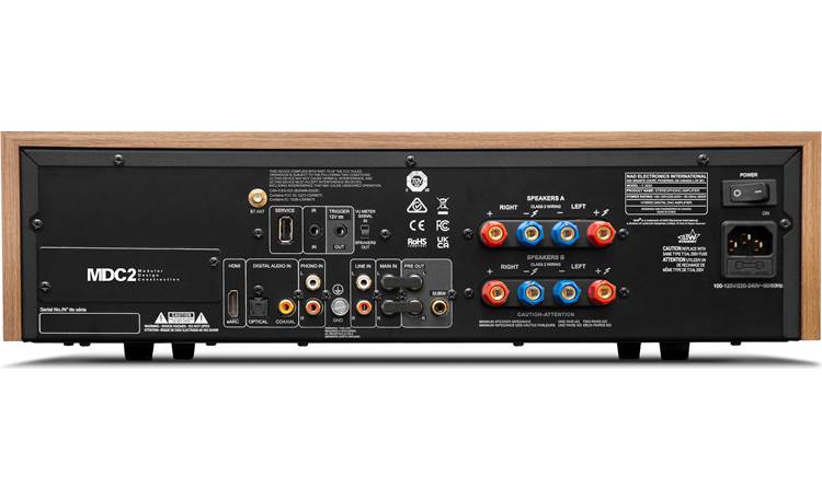

What is the model of your Cambridge Audio integrated amplifier? Do you know if it has the ability to be used as a power amplifier only? Generally if this is the case there are two jumpers on the back of the unit.

Hey double,
When you say there are ‘2 jumpers on the back’ what are you referring to?
OK here's what you need to do to use the WiiM as a preamp with your gear. The 740A does not have the ability to bypass its internal preamp and be used only as a power amplifier so you will still be passing the WiiM output through the 740A preamp.
