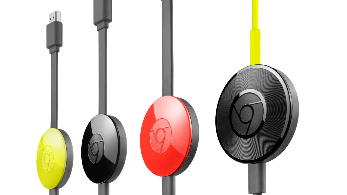

A lot of people complaining online that their original Google Chromecast audio pucks are no longer working properly.
Definitely a Google problem.
