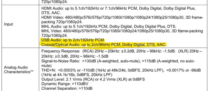

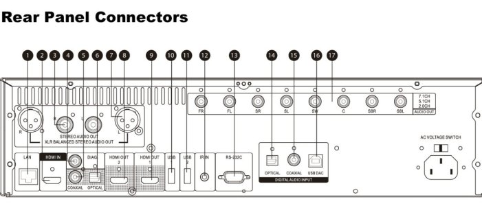

I hope this plan pans out for me. I just picked up a MINT Oppo BDP-105, it's basically a very high quality multi disk format player with two ESS Sabre32 Reference DACs. Why 2? Well one is shared for optical/coax/hdmi and the other is dedicated to the balanced XLR output, which is what I will be using, connecting the L/R XLR to my L/R mono block amplifiers.
Current setup is an Ultra, SMSL P-100 CD transport, Pioneer PL-510A TT, Fosi BT30D Pro amp, and a pair of passive speakers and an active sub where it's connected to the Ultra via coax LFE. The CD transport is connected via optical and of course the TT is connected to the phono stage L/R RCA/gnd.
What I want to do now is remove the SMSL P0100 cd transport, replace the Fosi BT30D Pro amp with two Fosi V3 mono blocks using XLR between them and the Oppo. I will still connect my active SW via LFE to the Ultra and my TT to the Ultra. What I feel is the best to do is connect the Ultra USB-A out to the Oppo USB-B (square printer type) digital input. Is this better than the coax out or optical out on the Ultra? If so why?
Finally, I have two older USB-A to USB-B cables, will they all work the same or should I buy a better one?
