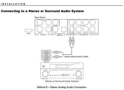

To enjoy SACD sound on a stereo system, here's what you need to do. I have this setup with a Sony Blu-ray/SACD player and it works great.

It's PCM coming out of the RCA, you will never enjoy DSD in this case. All players like the Oppo are the same. If you want to enjoy DSD you must use a 5.1 or 7.1 amp that supports DSD via HDMI. Otherwise you must do as described in the link, no choice.
