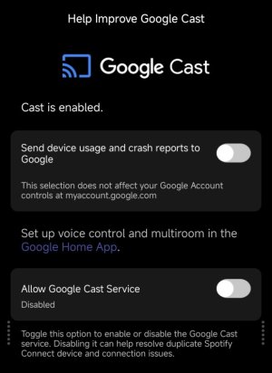

In my case, if I turn off 'Allow Google Cast Service' in the Google Cast section of the WiiM app, it will no longer appear in the Chromecast device list.

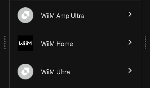

Does your Amp Ultra still appear in the Google Home app?
If so, try going to 'Security and Login' in your Google account and remove the WiiM Amp Ultra adapter in the 'Connect to third-party apps and services' section.

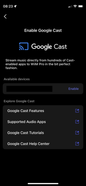

I see the same thing. I never enabled Google Cast:
But my WiiM Pro advertises _googlecast._tcp. via mDNS/DNS-SD.
I just tried enabling Google Cast, then turning off 'Allow Google Cast Service' in the Google Cast section of the WiiM app and then as @Wiimer says the WiiM Pro stops the Google Cast service.
Oh wow, I’ve actually never seen that "Allow Google Cast Service" toggle before. So Chromecast has to be activated first in order to be deactivated? That feels a bit counterintuitive... I’ll give it a try this evening.

I followed the suggested steps, turning off “Allow Google Cast Service” in the Google Cast section and resetting both the amp and the app several times. It took quite a bit of time, but the problem is still there: the amp keeps showing up as a Google Cast device on every device. It’s especially frustrating in Spotify, where it appears at the top of the Connect list with the same name as the Spotify-Connect device, so guests keep connecting to it by mistake.

If turn off Google cast in the WiiM app, will not normally see Google Cast in the Spotify app. (I have checked this many times.)

Turning off Google Cast in WHA also instantly hides it in the Spotify app.
