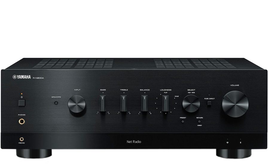

Hello guys!!
I was going to buy a Yamaha R - N800A
There are many options, all separately, an integrated amplifier plus internal DAC.... Wiin, that's the beauty of this hobby.
In any case, what my head is spinning is that this Wiim, the official website says that it offers 120w/channel/4oh and the Yamaha, which I am looking at, offers 100W/channel/4oh
Can this be true? Sometimes I have heard that the Ws of depending on which brand are not the same as those of another brand:
My only doubt or fear is how they are going to move my Dali opticon 6 mkII, the funny thing is that looking at the specifications... it even has more power than the Yamaha RN 800 that I am looking at...
So with data in hand, the fear would have to come from the Yamaha RN 800 and not from the Wiin in power characteristics, and, either I'm missing something, or it seems surreal to me!! 120w per channel!!! To reach that power in an integrated amplifier you don't need to go below €1000!!
On the other hand, I have read on the official Wiin forum that they recommend monitors, which I don't quite understand, because with that power they "should" be able to move some towers with ease!! There is a cat locked in the power that they indicate or not...
What is your opinion?
Forgive my English, I'm from Spain.
