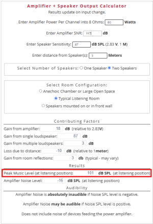

As an example, let's use the Benchmark Amplifier + Speaker Output Calculator to see what kind of level you could expect from WiiM Amp Pro driving a pair of Elac DB63 loudspeaker at 3m in a typical room:
So we see you should be able to get approx. 101 dB SPL peak at 3m distance with this combination.
If we now assume 14dB of headroom (I'm taking this value because most streaming services are normalized to -14 LUFS) you get approx. 87dB SPL average level at the listening position (but being able to handle peaks up to 101 dB SPL).
If we instead assume a closer 2m listening distance the numbers change and you now get 91dB SPL average (with 105dB SPL peak, assuming the same 14dB of headroom).
As you can see, there's a lot of assumptions involved here but hopefully it illustrates the principles and might help you decide what you need. Good luck in your search and have fun! :)
