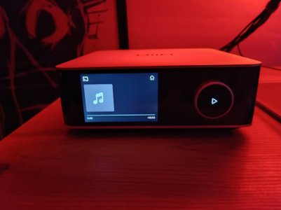

Is anyone else seeing a lack of metadata being properly displayed when streaming to the Amp Ultra when using Google Cast from Lyrion Music Server (fka Logitech Media Server)?

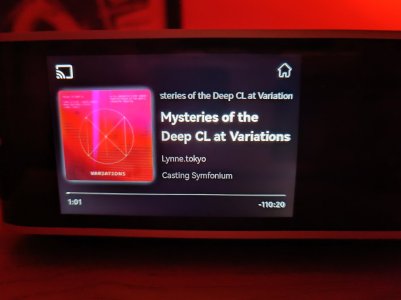

This is in contrast to what is seen when using Google Cast from other applications. Please see below for an example:
Leaving aside why you’d want to do that in the face of the Wiim’s squeezelite client which has no such issue, I see similar results for both the Amp Ultra and Ultra using LMS’ Chromecast bridge, even though the WiiM Home app in Android happily shows the artwork and metadata.
Chromecasting from YouTube Music, for example, works ok on both the WiiM screen and app, but I get different results sending from Bubbleupnp over Chromecast where I get the metadata but no artwork on neither the screen nor the WiiM app, but that might be a setting buried deep with Bubbleupnp that I haven’t found.
The issue at first might suggest that there’s an issue with the Chromecast bridge in LMS (the upnpbridge plugin shows no such issue), but the fact that the WiiM app doesn’t have the issue could suggest otherwise and that it’s perhaps a WiiM screen firmware issue.
