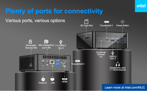

after 5 days testing BETA firmware (with HDMI Fix) on Wiim Ultra... its WORK without Problem IF NOT Connected to MINI PC on any HDMI Input 1,2 or 4 .....
HDMI CEC NOT WORK, if i connected with MiniPC ( Intel NUC11 i7 ) ....

It looks like some of the other connected devices or cables are somehow disturbing the CEC signal.
CEC is a common signal bus for alle HDMI ports, so if one port or cable fails, it will cause all CEC signaling to fail.

thanks for info... that statement make me find the real problem on my wiim ultra configuration...
before that, i connect nuc11 from Mini DisplayPort to Sony TV,,,
yesterday i switch from MD port to HDMI connect to Sony TV.... i run smoothly... without hdmi cec error... but i need more days to verify it... NUC11 PAHi7.PNG
