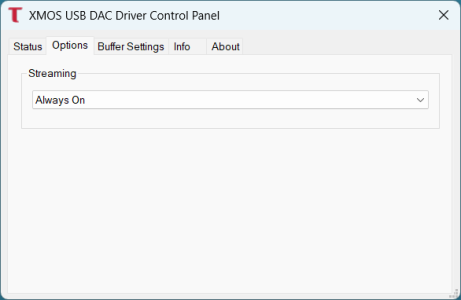

I am experiencing something very similar with USB audio output from a PC via a SMSL PO100 to the optical TOSLINK port on a WiiM Amp. I've noticed that when nothing is playing it takes about a second or so to recognise the signal and start outputting audio. Until I saw this thread I assumed it was the PO100 or the Windows driver.

As far as I can tell, the SMSL PO100 is continuously outputting a signal, as indicated by the driver setting, and the LED light on the hardware itself.

Are you actually switching sample rate though? I am not, the SMSL should be outputting a continuous 48Khz audio stream. It seems like the WiiM is detecting that the stream is silent and going into a low power mode, which then takes a bit of time to come out of and "re-lock the signal".
