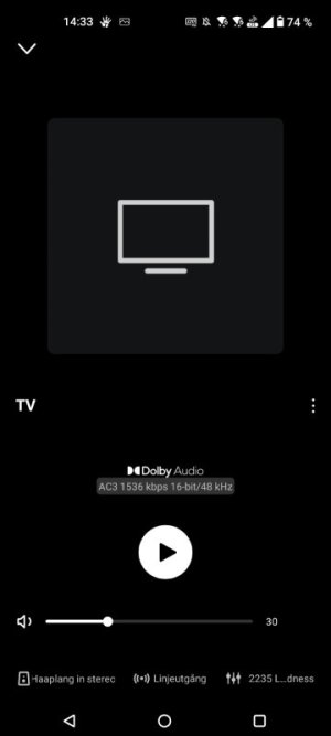

After trying all of my streaming services using Pass-through this is what is showing on the Ultra. When using my Blu ray player it says LPCM. So as long as it works this should be a cleaner way of doing it right? Cause I am guessing the Wiims Internal sound processing will do a better job than the LGs?

In general, yes. For instance, PCM can encode 7.1 or 5.1 or 2.1 or 2.0, but the Ultra cannot directly handle a few of these yet it is unlikely that your LG TV exposes any transcoding controls beyond PCM vs Pass-Thru. However, realize that the source Audio Format is dictated by individual TV Apps and HDMI Inputs. So Pass-Thru might send PCM Stereo for one App, and Dolby Digital 5.1 for another, yet source DTS or ATMOS for others (formats the Ultra cannot handle).
I actually did try playing a Blu-ray with the DTS HD track using pass-through. It worked fine and the Wiim was showing LPCM on it's screen. I guess I could just continue with pass-through until I (or if) I run into something where it wont work, and then and only then go back to PCM. What I like about pass-through is that the volume from the TV matches the volume from streaming via Ethernet way better. If I use the PCM setting on the TV I have to turn the volume up like 20-30% more than when using pass-through.
