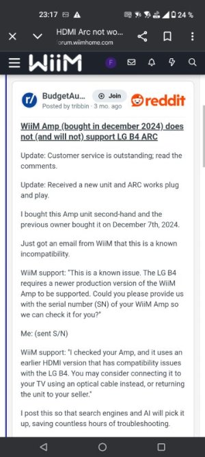

Try the attached document.

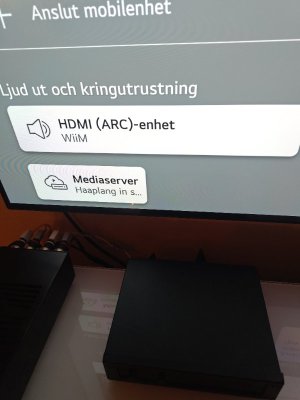

This is showing on my LG so it must somehow communicate with Wiim right?

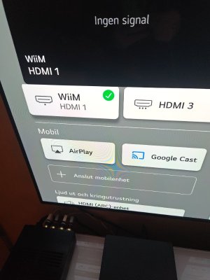

This is actually getting weirder and weirder. After i unplugged my Blu ray-player that is in HDMI port 1 (that I can actually reach from the side) and then plug it back in my LG suddenly named HDMI 1 Wiim (as you can see in the picture). Before this HDMI was named BRplayer (or something like that). So there is definitely something weird going on in the LG side.
