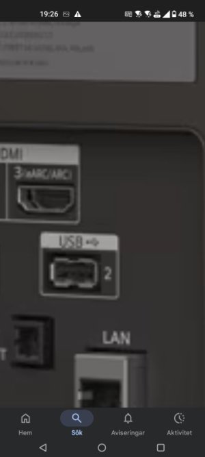

Here you can se how it looks on the B5 so it is one port for ARC and eARC
