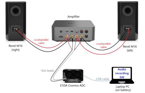

Here's an illustration of the basic recording layout:
Note: One difference with the equivalent WiiM Amp Pro layout was that I connected the Amp Pro subwoofer RCA sleeve to ground. An explanation can also be found in the related thread (link).
After the connections were made, I did a few basic measurements of the output to ensure everything works well:
