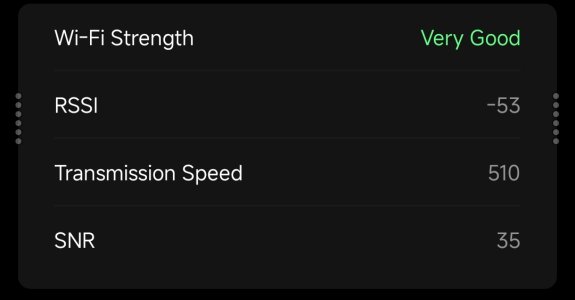

Other things I noticed, I like the volume knob better on the pro. It feels heftier and turns smoother. Also for some reason, the ultra detects my wifi but will not connect to it unless I place it right next to the router. The pro didn't have this problem, nor has any other device I have used. Not sure if this is due to a defect or model design.
Hi,
My Amp Ultra is located 4 m away from the router, with two walls between the router and the Amp. However, the Amp Ultra's Wi-Fi reception is fine.
Moving or re-orienting the router (or device) slightly may improve the situation.
I did try moving the router a little closer but didn't help. I assume there might have been a defect but ultimately didn't want to fool with it and returned it. However the difference in sound produced was surprising. I ended up returning my last speakers because they seemed to not have enough treble but I wonder if the wiim amp ultra would have produced a much brighter sound from them.
