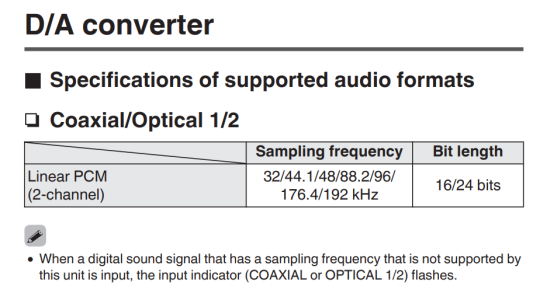

When tested with Wiim Home App for the SPDIF Output resolution, 192 KHZ 16 bits and 24 bits, there are no sound coming out when playing test audio. Other sample rares and bit depths are fine. Does anyone have such issue? From the manual of Marantz, 1676090772273.png
What optical cable are you using? The one that came with the wiim?
Do you have another you can try?
Is the cable loose, or coiled tightly at all?
I have a 6006 in the other room... I should go and try it...
