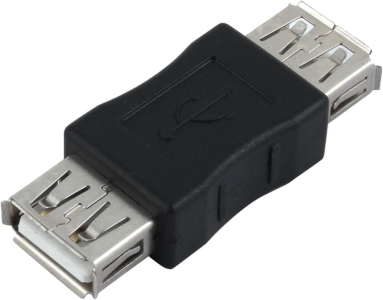

I'm going to try this adapter from Amazon as it's just $6 opposed to the $40 Apple adapter. If the adapter doesn't work I'll buy the Apple adapter. Normally don't have an issue spending money for this hobby. But $40 for an adapter I'll only use a few times has me looking for lower cost options.

I don't see how this USB A female to female adapter - however cheap it my be - will help you to connect an old UMIK-1 to an old iPhone. :unsure:
It's an iPhone 13 with an Apple Lightening plug so it's not that old. The UMIK-1 has a USB Mini input. So I need a Mini USB to Apple Lightening cable. But I've been unable to find such a cable that will also provides power for the UMIK-1. So I have plenty of Apple Lightening to USB-A cables and a few USB Mini to USB-A cables.
So that's the reason for ordering a USB-A female to USB-A female adapter. Whether the two cables mated together with the adapter will provide power is unknown. But I'll know tomorrow.

Well I've realized that my iPhone 13 will not power the UMIK-1 unless I use the Apple Lightening to USB camera adapter linked below that was also posted earlier in the thread. The USB-A female to USB-A female adapters work fine when plugged into my Windows 10 laptop but the iPhone 13 will not power the UMIK-1.
