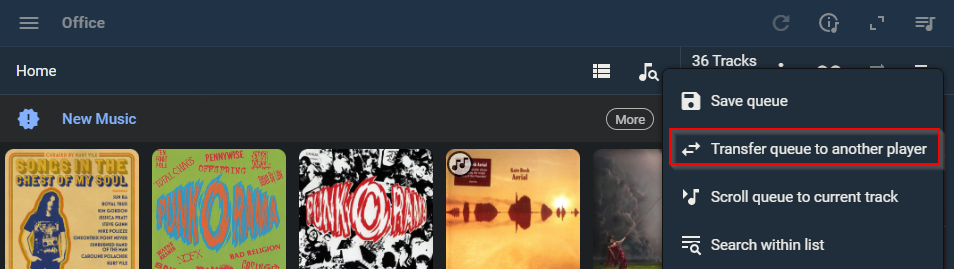

If you were to install Lyrion somewhere on your network and use the Material GUI for control instead of WHA then queue transfer between players is simplistic. Granted it does not support Amazon Music but it does support almost everything else.
This is screenshot from PC but it is virtually identical on a phone / tablet
