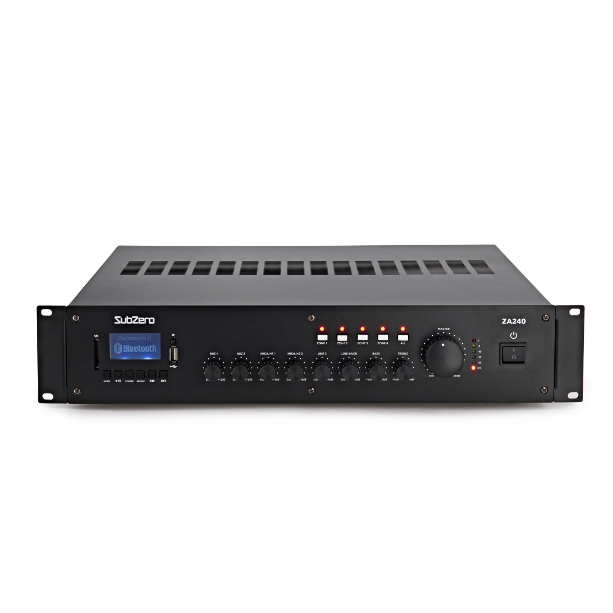

I will also add a question. Are all speaker cables terminated in one place? If so there are other ways of achieving multi room sync.
I would like to hear other ways of achieving multi room sync as I am in a similar setup. All my speaker cables terminate in one place.
