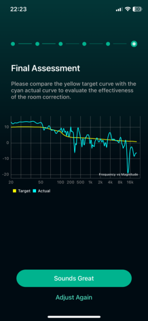

Here is the current result.
250-400 Hz is the fireplace resonance, please ignore it)
