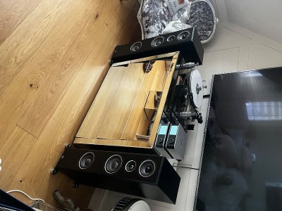

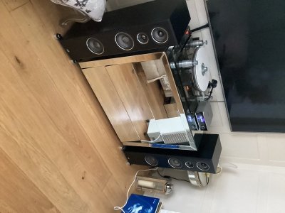

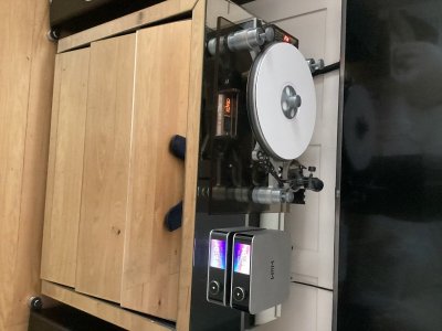

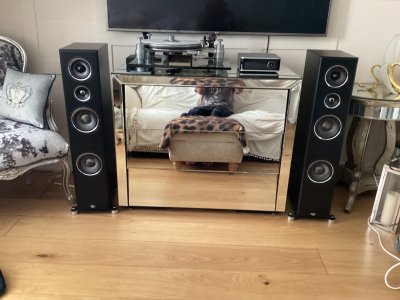

Could you share a picture of your setup, showing how the Cambridge compares in size to the Ultra?
Hi P
This is my setup.
MXW and Domino live in top drawer.
I have spent many thousands of pounds on Hi Fi over the years and have to say I am very happy with this little rig.
