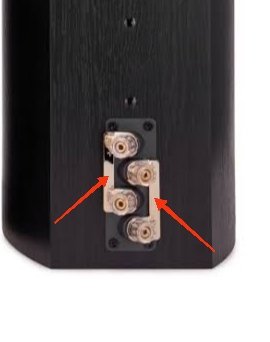

OK, first things first: Are the bi-ampring brackets screwed down tightly on the back of both speakers? Did you connect the speakers using loose cable ends? If so, double and triple check that no single wire strand has escaped from the binding posts on the speakers and on the Amp.

As @harkpabst said, I believe it is the bi-wiring brackets on the speakers. The brackets are not attached and the speaker cable appears to be disconnected from the tweeter.
If you are not sure, post a picture of the speaker terminals and the back of the amp here. (Please unplug the power cable of the WiiM amp before proceeding.)

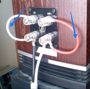

If your speakers do not come with bi-wiring brackets, make a short cable like this to connect the tweeter and woofer terminals.
