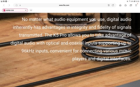

DAC wise I'm using a K5 Pro ESS. I don't have another source with optical output at 192kHz/24 unfortunately. What I haven't tried is the optical output into my CXA61 directly - I'll try that tomorrow (if I can persuade her in doors I should keep it for another day before she has it back πŸ€·β€β™‚οΈπŸ˜‰πŸ€£), thanks again πŸ™
Thanks @Mr Ee,
That looks like the answer right there - I need to RTFM before asking questions on forums πŸ€¦β€β™‚οΈπŸ€¦β€β™‚οΈπŸ€·β€β™‚οΈπŸ€·β€β™‚οΈπŸ‘ŒπŸ»πŸ‘ŒπŸ»
Well, sometimes manufactures only state support for up to 96khz on optical even though 192 often works, to cover themselves for when it doesn't!
For manufactures to state 96 for coax too usually means 192 is v. likely to not work, but as 192 over coax seemed to work for you then I guess your options are to stick with coax, or go optical and set the wiim to 96 max.
