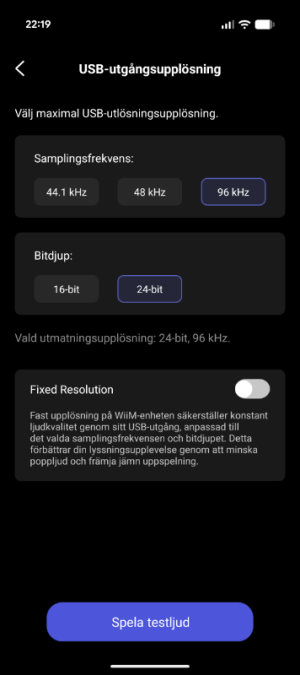

Hi,
I have my WiiM Ultra connected to an Arcam Radia A25+ built-in DAC. The DAC is capable of 384kHz/32-bit but the WiiM Ultra is only recognizing max 96kHz/24-bit despite the WiiM Ultra capability of 192kHz/24-bit.

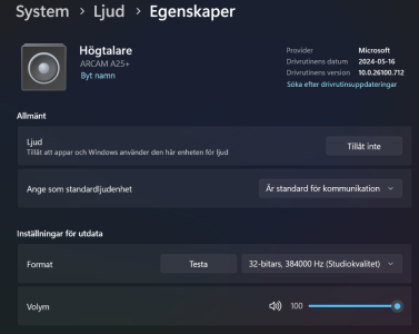

Windows works with and recognizes up to 384kHz/32-bit as it should so 192kHz/24-bit should not be a problem.
I use a short high quality USB cable (same as for the Windows computer). Have tried power cycle & reboot the WiiM Ultra. Dis/re-connect the DAC all with the same result, max 96kHz/24-bit.
UAC 1.0 maxes out at 96kHz/24-bit so it might be stuck with that despite being UAC 2.0 compatible.
Anyone have any ideas about what could be the cause?

Raise a ticket to WiiM when you connect the DAC so they can inspect your device logs for clues

Thanks, now done! Did write the ticket with the DAC connected.
My Topping D30 pro DAC only allows me to select 32-bit, so I previously submitted a ticket regarding this issue. This is the response I received from the team at that time.
This issue occurs because the UAC you are connected to only supports 32-bit, which is why it cannot be selected.
Thanks, will write back in this thread what WiiM responds to me. USB seems quite complex to implement for all the different devices to work as intended.
@Wiimer Recently got response from WiiM customer support (super quick, thanks WiiM) and having ongoing troubleshooting. According to the logs the DAC is recognized as UAC 1.0. Since it's capable of UAC 2.0 in Windows it seems the DAC is stuck in compatability mode on the WiiM Ultra. Will update further when I hear back from WiiM again.
