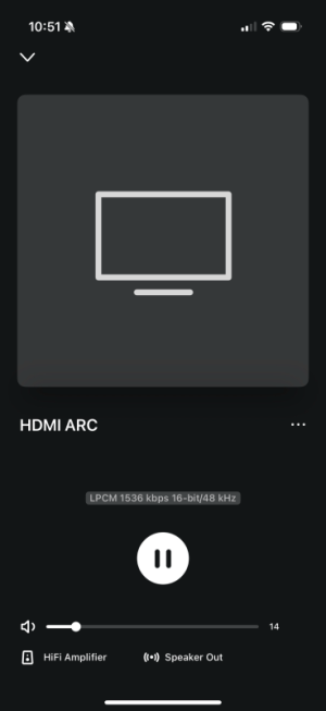

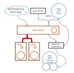

I updated the firmware as soon as I opened the box, a few days ago. My goal is to connect a DVD player to play CDs and an Apple TV to the HDMI port on the Wiim Amp (not Pro). I don't have an ATV yet, but the DVD player isn't working. I have a cheap SPDIF extractor and I can siphon the audio into the TOSLink port, but I'd rather not. The phone app tells me that the DVD player is connected, and shows the data rate, but the light on the Amp is orange (amber) and no audio. Is there a way to do what I want WITHOUT putting a whole TV with ARC into the chain? Is there a known-good HDMI switch that will correctly pass HDMI audio to the Amp?
I have a 1Mii DS700 that I works great as a "USB DAC" to route the Wiim streaming services or TOSLink sources out to my Sony XM5s (BT-LDAC). It has a TOSLink in and out, but I don't want to turn it on if I'm not using the headphones. If I use the HDMI audio extractor that I have, I have to reconfigure the DS700 every time I switch from Amp to Headphones.

It's not actually deciding anything. :). The pins that carry the HDMI audio signal are certainly not even connected to any audio circuitry. Remove the HDMI cable, select HDMI as the input and tap the Play button on the WiiM Home app playback screen. You will see the same data rate, bit rate and sampling frequency displayed. It's just a default placeholder.
