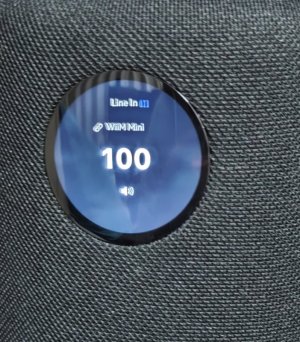

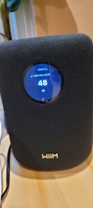

My issue is that the Wiim Sound appears to be playing (the screen shows connected and the wiim home app shows music playing)
But there is no sound coming from the Wiim Sound.
Yes I've got the volume turned up!
Any ideas please? It's so frustrating.
I can't see a aux output... but the shop we bought it from did a demo using the Pure and the wiim mini and wiim sound.
I'll phone and ask how they did it.
I'll get back to you and let you know.
Your Pure Stereo only has a 3.5mm headphone analogue output. The two RCA jacks you are using are INPUTS on your Pure. Leave them there and connect them the OUT of the WiiM Mini. This way you also play from the Mini to to your Pure.
To solve your current problem though use a simple 3.5mm jack (both ends) cable to connect from the headphone out of your Pure to the line-in on your Mini.
