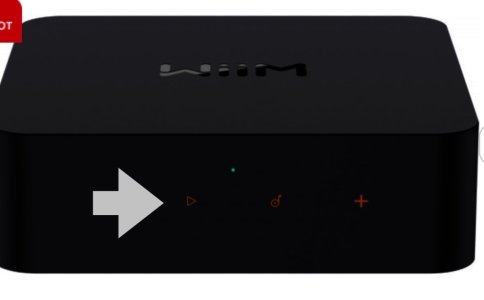

My Wiim Pro Plus seems stuck in mono - I've set to 'stereo' in 'audio settings' - but get the same mono output on both channels when in L, R , Mono or Stereo also Volume Balance Control does not work (has no effect) - I read someone with the same problem solved it with a Factory Reset but I can't find out how to do it - searching Wiim help with 'factory reset' brings up nothing helpful. My input is via ethernrt - Have tried source : Deezer and Internet radio - Any help with the issue (or how to do a factory reset) would be appreciated
Did you try to disconnect the WiiM Pro Plus from its power supply for a couple of minutes before initiating the full factory reset?
And just in case, did you try a different power supply?
