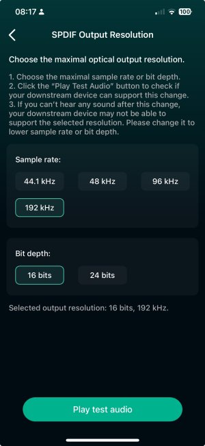

So here's a question - this setting to choose the maximal optical or Coax output resolution - talks about 'to check your downstream device can support this resolution'... which makes me think > is this setting only applicable if you are using an external DAC?
You only use that setting if you’re using that digital output, there’s a similar setting for the optical SPDIF output, so yes it’s only relevant when you’re not using the WiiM’s DAC and passing that job to an external DAC.
Re missing this setting, didn’t the setup procedure offer you to test the audio output and hence those settings? Been a while since I set mine up but seem to recall that
